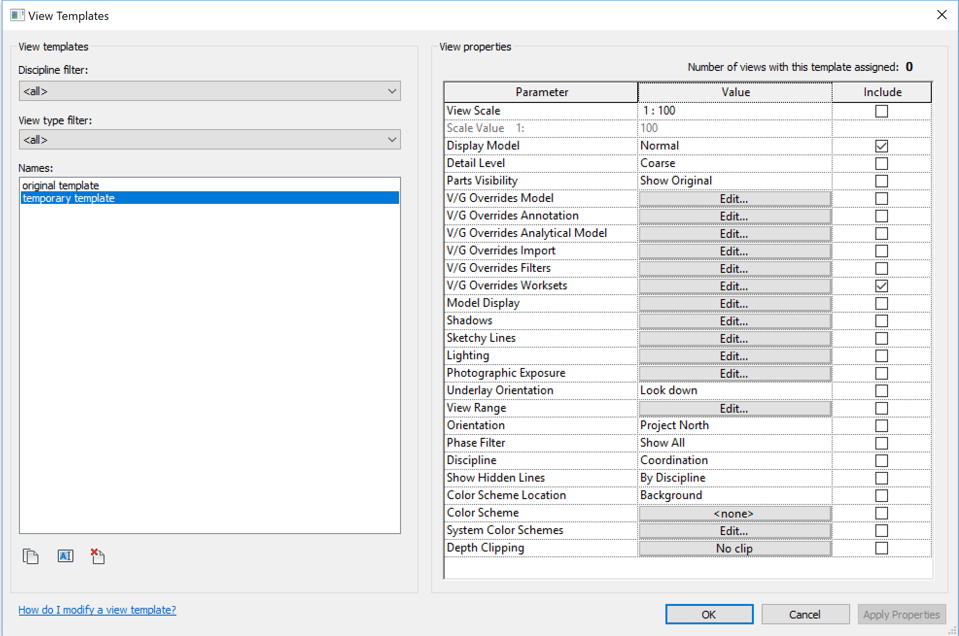

What i mean is something like this:
The richtclick command Apply Template Properties.
So:
Store in excel the name of the view, UniqueId of the view and the original viewtemplate name.
With the nodes for setting the template set to this:
Then revert back to the original viewtemplate.
The tickmark in the second picture should only be set to V/G Overrides Worksets (my bad)
Marcel
