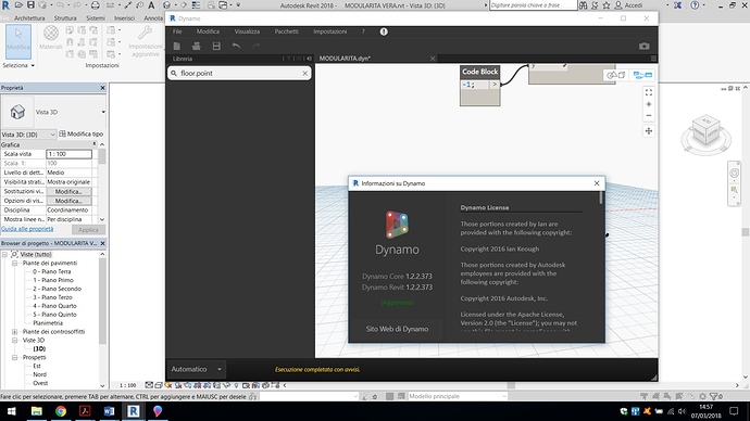

Sorry but I don’t find it in the search bar. I am using 1.3.2.0 version of Dynamo.
i have version 1.3.2.2480
it doesn’t compare anything.

Your picture shows 1.2.2.373

@federicamonna, that node doesn’t exist in 1.2.2 which is the version you are running. You need to update to 1.3.0 or later in order to use the node in question.
Go to the most recent version of 1.3.2 (or later for folks reading this in the future) when you update so you get all the goodies and updates when you do.
Thank you to everybody! Now I have the 1.3.2 version and the node is in it!
