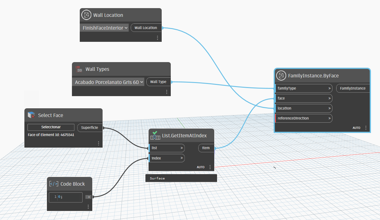

Hello @REMZARCK and welcome to the forum, yes think that one need mass surface, you could try something here, with these limit wall by face give
hello @sovitek, I don’t know if my execution is correct
but I don’t know if it’s understood what I want to do. It’s something like this:

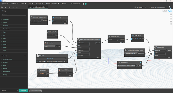

he showed me these mistakes
Hello @REMZARCK hard to say…but try with Default instead of default in material name…
I did it!! I managed to generate a wall on a selected face. However, I still need to reproduce nodes that allow me to create multiple faces at once with walls independent of each face. I also need to generate a mirror so the walls don’t point inwards.
Unfortunately it only works with full surfaces, if you have a window or door or cut it won’t work.
Muro basado en cara intento 11.dyn (47.5 KB)
