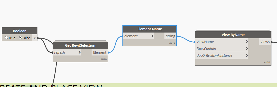

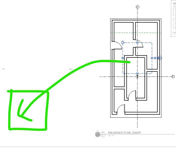

I would like to select a callout (plan, elevation, section) on a sheeted view, then have that view placed on the sheet. How do I get the ‘view’ from a selected callout? I feel like I’m missing a node.
Bumping this up—is this not possible?
You’re not selecting a View, you’re selecting something that is referring to a view, so you would need to ask the reference for it’s view.
Use Snoop or a Element.parameters Node to do some research about what properties the View Reference has and how they are called. Then you can decide what Nodes/Functions you need to ask for those properties.
