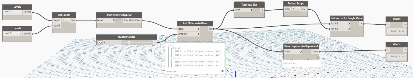

yes i am sure it not a 3D View i think it is the python script…? see attached screen shots.
1: is the script i am trying to run and

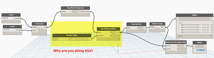

Hi Einar
I just added the screen shots below.

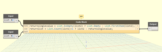

I found the issues it is the Return List Or Single Value Node…

In that case replace List.IsEmpty with DSCore.List.IsEmpty and so on in the custom node and save it.
Yep done the changes to “Return List Or Single Value”… it appears that the python script is working fine its just the node that isn’t…

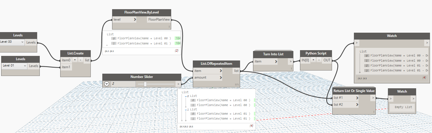

Yes, but when quickly trying your workflow, I see that List.OfRepeatedItem is not creating any view, so it could simply be impossible to create dependent views from views that don’t exist already…

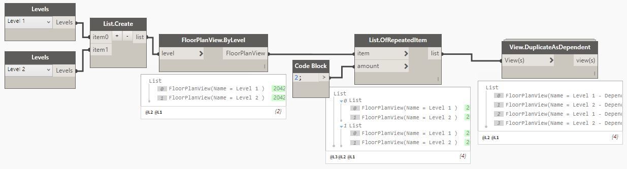

The Views are created before List.OfRepeatedItem by FloorPlanView.ByLevel and List.OfRepeatedItem is creating the amount of times i want to duplicate the existing view. see below
OK, now this works for me, I simply plugged View.DuplicateAsDependent just after List.OfRepeatedItem, such as in the first graph…
