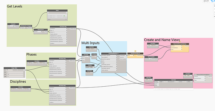

I am attempting to create a script that will give 3 series of check boxes: level, discipline, and phase. I want it to create the views, name them, and finally apply view templates. I am struggling with how exactly to map out the user inputs with the action I want to be performed. Any advice would be appreciated.
viewcreationforum2
was trying to do a similar thing, but only used one of the list view nodes. I would like to improve and separate by level. Hopefully we can get some help from the adepts in the forum.
try changing the values to the output from all elements. I believe Keys are a “Description” and values should have ID, at least for the level one. pop open the results form the UI form and you will probably get three list, that than can be used to create views. I used the index to recall the ids "pass through ".
The inputs seem to be working well now. However, I can only seem to create one instance of each level. Instead of every iteration selected.

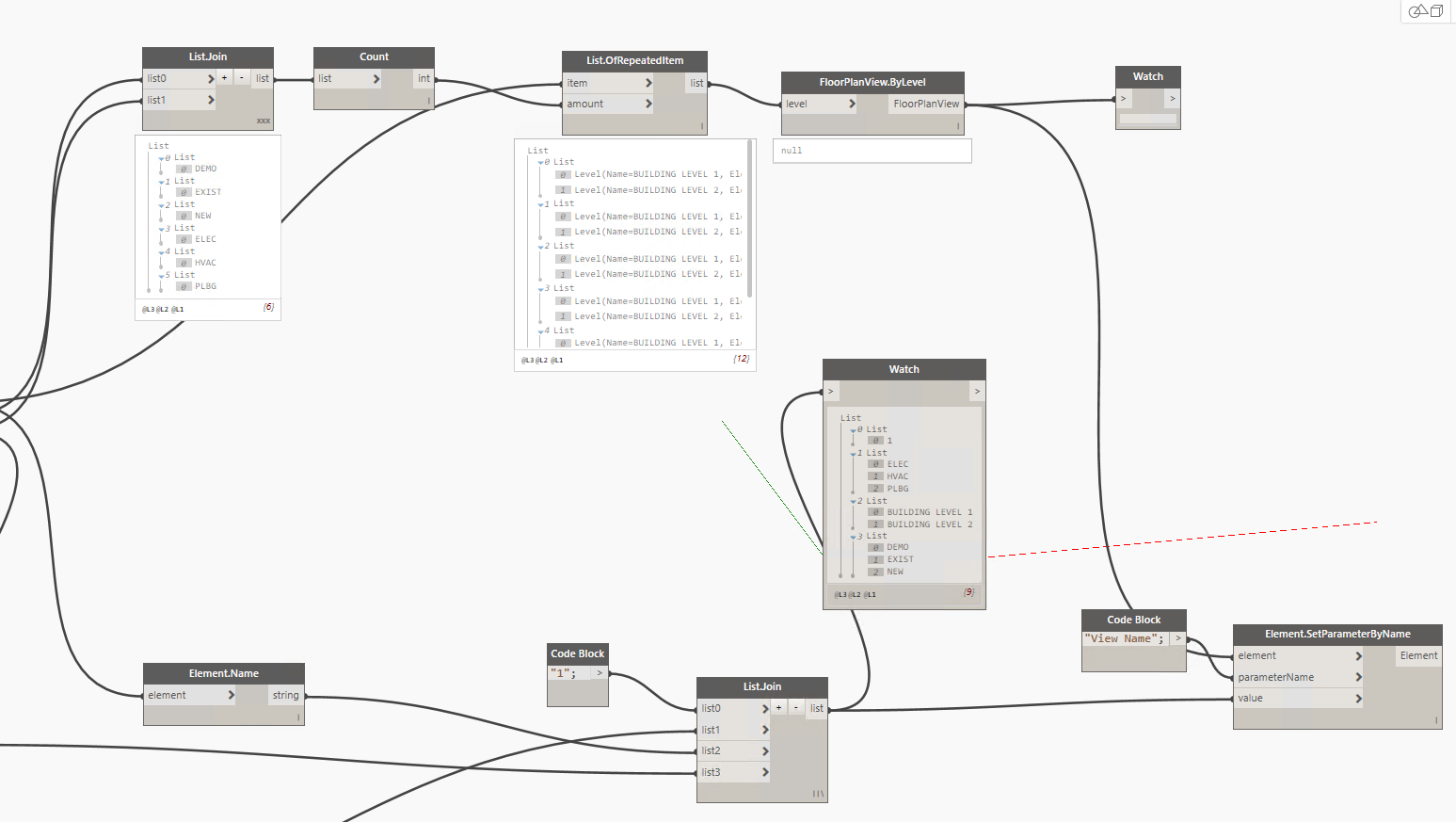

You need to feed the FloorPlanView.ByLevel multiple instances of the level if you want it to create more than one. If you want it based off of the number of items checked later on (discipline, etc) you can connect those outputs to a Count node and make a list of repeated item with the level like so:
Awesome, thank you! The repeater was the missing node I needed. Now if I can just figure out why it’s only naming 2 of the 12 views correctly…
I think this is due to your list structuring not matching between your Code Block output and your FloorPlanView.ByLevel output. If you could upload your .dyn file it will help to troubleshoot without having to recreate the conditions !

You are definitely onto something. The output of my two lists do not match up.
I’m so close I can taste it! My list structure matches between my lists for creating floor plans and naming them. Maybe I need to separate the groups of floor plans (by phase for example) and each one would have it’s own FloorPlanView.ByLevel and Element.SetParameterByName nodes? Right now I combine the lists of names and levels first, then try to generate the whole list at once.
