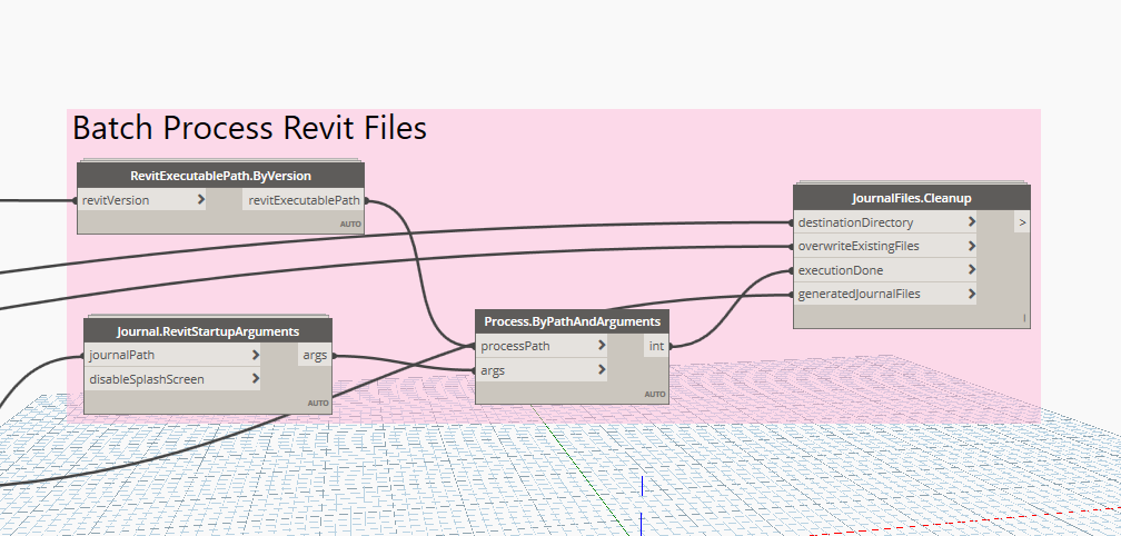

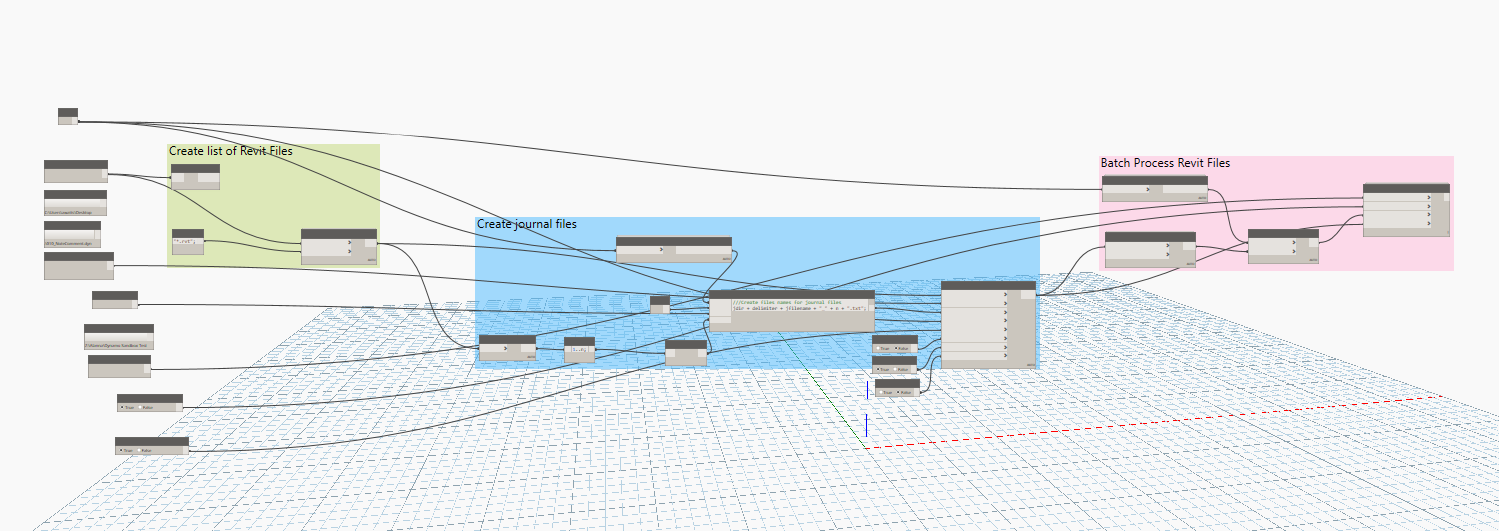

I have been using Andreas Dieckmann’s elegant master/slave script in Dynamo Sandbox to Automatically Open Revit Files and Run a Dynamo Script.
DynamoAutomation Master/Slave graph .
It works beautifully, but I can’t seem to get Revit to close the file. Or Save or Sync or allow me to not save and close. I have seen a number of other have the same issue on this forum. I apologize if this is the wrong string to discuss this. The graph is the same, except for it has the updated node Journal.ByWorkspacePath.
MasterScript3 MasterScript4

Basically, the Dynamo for Automation package uses Dynamo Sandbox to launch Revit, open a Revit file, open Dynamo for Revit, open a Dynamo for Revit ‘slave’ graph, run the ‘slave’ graph, close Dynamo for Revit, close the Revit file, and close Revit. As a result don’t need or want the Rhythm nodes in your current graph, but in the Dynamo for Revit graph which you are automating.
The ‘slave’ graph noted above should not contain any background processing (you are already doing said processing), but it may want to sync and/or save the graph at the end of the run. Because these slave graphs are being run in a headless Dynamo for Revit environment, they will have access to the Revit API and the associated Dynamo for Revit nodes.

Hi Could you please share your dyn file ? Are you busing Sandbox or Dynamo in Revit ?
