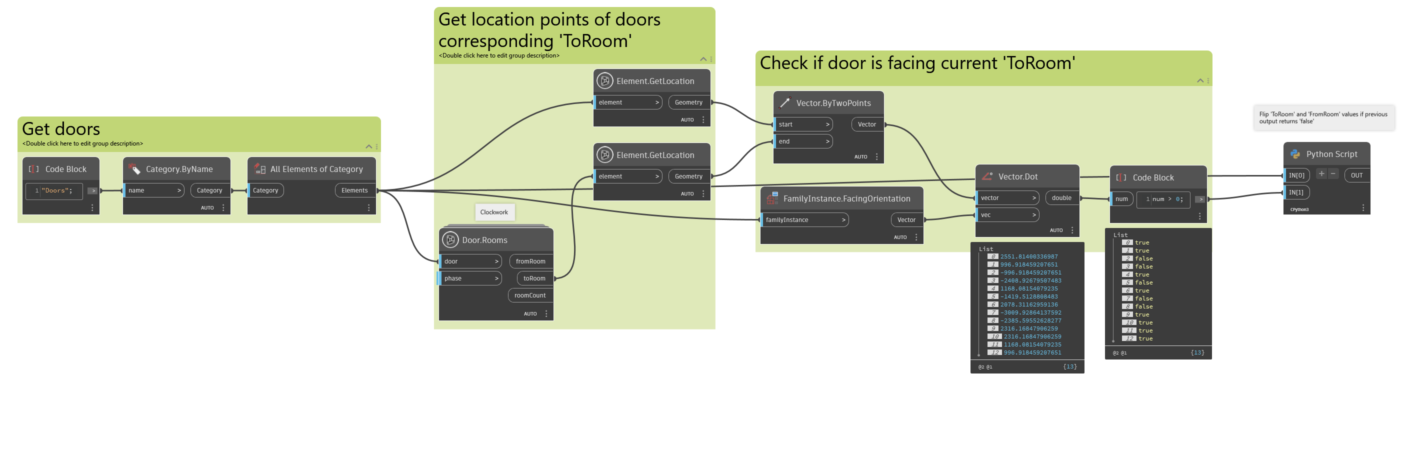

Thanks Gavin. I also figured out an alternative solution.
  1. Get door elements
  2. Get location points of door elements and current ‘To Room’
  3. Generate a vector with the door location as a start point and the ‘To Room’ location as an end point
  4. Check if each door is facing the current ‘To Room’ by getting the dot product of the Step 3 vector and the door FacingOrientation vector. (Positive dot product means the door opens into the current ‘To Room’, negative dot product means the opposite.)
  5. If the dot product is negative, flip the ‘To Room’ and ‘From Room’ values (using the Python script below for this.
Script:
import sys
# Import DocumentManager
import RevitServices
import Revit
# Import RevitAPI
clr.AddReference("RevitAPI")
# Get the active document from the DocumentManager
doorList = UnwrapElement(IN[0])
isFlippedList = IN[1]
# Place your code below this line
for i, isFlipped in enumerate(isFlippedList):
    if isFlipped == False:
        doorList[i].FlipFromToRoom()
OUT = doorList
Do you see a downside to this? This approach doesn’t allow users to manually adjust the To and From values, but it will ensure the values are set correctly based on door swing direction.

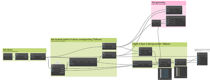

I had to tweak the graph and add some additional logic in the Python script to get exterior doors to work. The updated graph and script are below. I’ll provide updates if I run into issues, but so far this is working well.
Screenshare - 2024-03-23 6_40_52 PM.mp4 [video-to-gif output image]
import sys
import Revit
# Import RevitAPI
toRoomList = IN[2]
fromRoomList = IN[3]
    #First condition: current ToRoom value is null and door is facing room
    #Second condition: current FromRoom value is null and door is facing away from room
    #Third condition: Door currently faces FromRoom, and ToRoom and FromRoom both have values
    if \
    (toRoomList[i] == None and isFlipped == False) or \
    (fromRoomList[i] == None and isFlipped) or \
    (isFlipped and (toRoomList[i] != None and fromRoomList[i] != None)):
OUT = doorList
