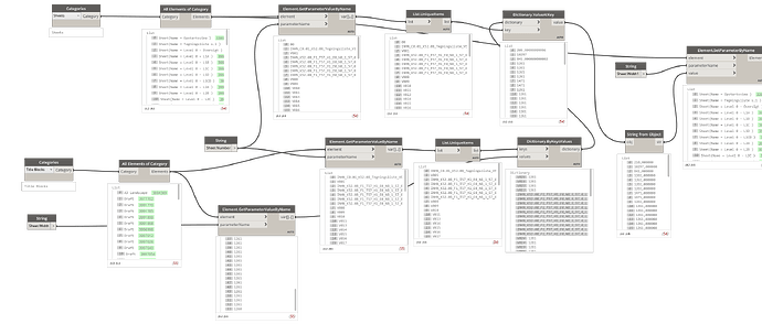

My issue is that the Width it puts on the sheet is wrong sometimes and i can’t figure out why. This is what the script im runnig looks like i modified it a bit to make it run. My only guess is that it doesn’t allign the sheets and title blocks correctly. Any help is appreciated

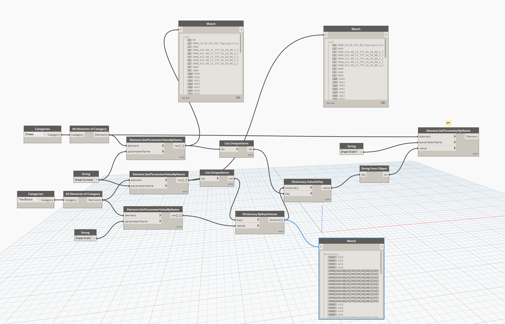

Can’t tell until you expand the node previews - hover over the node, wait for the ‘pin’ to show up, zoom in nice and tight so you can read the node names, and export your canvas as an image (camera icon or ‘export’ text in the upper right hand corner of the screen).

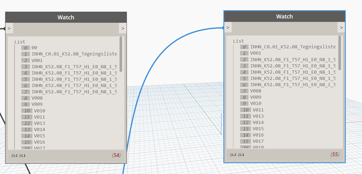

Cant see where as the data set is too long, but it looks as if the List.UniqueItems is causing the key/value pairs to shift into a non-functional order. Do you somehow have two title blocks on a sheet?
