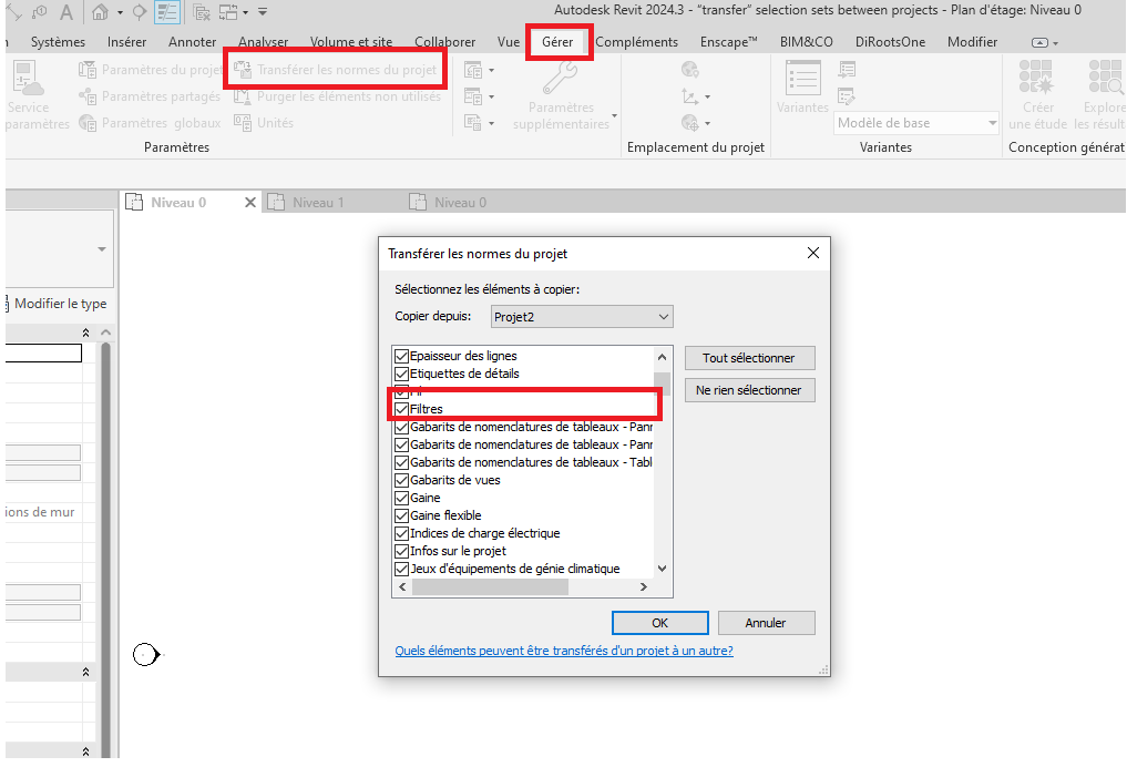

Hello, in this case you don’t need Dynamo you can use Revit instead. There’s a tool available to transfer elements and filters as well.
you can only transfer rule based filters
