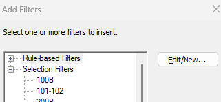

thanks Nick, so how do you add selection filter to view? i didn’t look at API side yet, assume it’s doable via API
What do you mean by that? How would you add a selection filter to a view through the Revit interface? Are you wanting to isolate that selection in a view? Are you wanting those elements selected to annotate in a certain view? A selection filter probably be more appropriately named a filtered selection. It just selects elements. Once you have them selected, what do you want to do with them?
just like rule-based filter, you can add/remove selection filter and hide/override, i need to copy to other views
I see. So you’ve already used the selection filter to create the corresponding view filter and now you want to select it so you can copy it to other views. Is that correct?
You’ll have to use the API for this. It’s fairly straight forward with GetFilters and AddFilter. Here’s an example of adding a filter, which I’ve confirmed does work for SelectionFilterElements.
