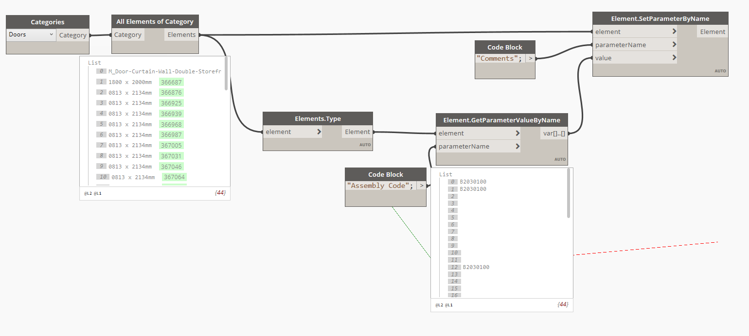

You should look for GetParameterValueByName and SetParameterValueByName.
Hi @brede! Here is a suggested solution for you!

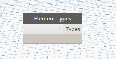

Thanks, how do you find that node Elements.Type?? I only got this:
in the browser
