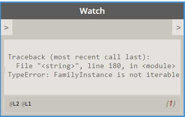

I’m allready using the Genius Loci package. Both of the Anno-tag notes give the same error: familyinstance is not iterable.
This is the line with the error: for i, j in zip(elements, locationPts):. I tried to trace back the familyinstance that wouldn’t be iterable. For some reason the elements imported can’t be found. My input for elements is a list of generic models (I also tried just 1 element).

Can you provide a Revit test file, your dynamo graph and your Revit version ?
It’s not possible to help you with so little information.
