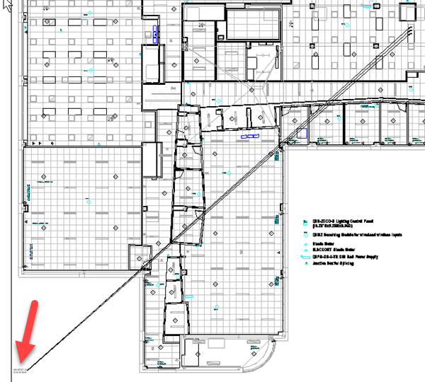

Tag.ByElement tags very far away from elements
For some reason Tag.ByElement is positioning the tags all they way in the corner of the view. I tried using offset values, toggling the isOffset input, and still getting the same result.

Using regular manual tagging works fine, it tags right next to it. Maybe it’s something with the .rvt file.

I am just creating the JB’s and tagging them in an existing view
