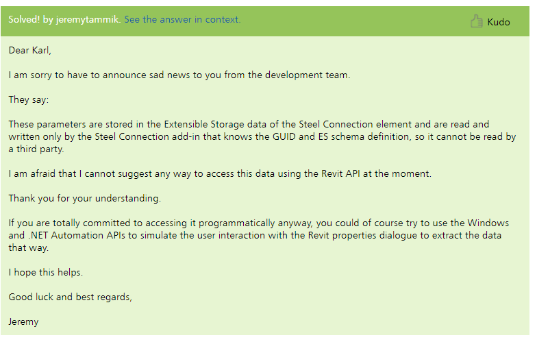

Have a look here:
https://forums.autodesk.com/t5/revit-api-forum/accessing-detailed-parameters-in-a-structural-steel-connection/m-p/6428794/highlight/true#M17231
Thank you!
