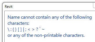

For some reason, when my script runs it creates “Unnamed” sheets, I’m not sure how to remedy this issue, the excel file i’m working from has everything named correctly, it seems to be creating new sheets.
EDIT:An example from that image M-24008 should be named as M-24009 is named, but M-24009 doesn’t exist.
EDIT2: Not sure why there are Nulls?!
Your sheet names most probably contain illegal characters:
