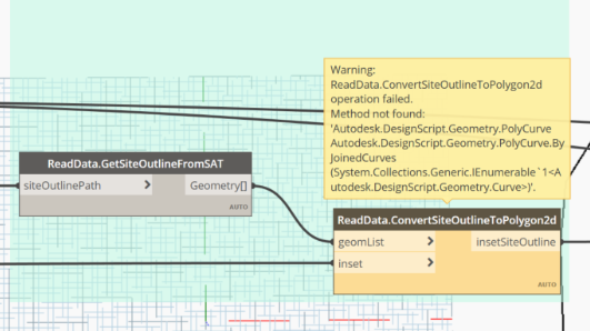

Tried downloading it and upon opening it up came across a few warnings that aren’t letting the package run on the sample file “Space Plan Generator”
It is saying there are a few Methods that are missing in the example file. Any idea what is causing the problem?
Dynamo File/Example that was provided - Space Plan Generator.dyn (74.8 KB)
I have the same problem, but haven’t found a solution yet.
After some research I found that it works in Dynamo 1.3.4, but not in 2.0.2.
