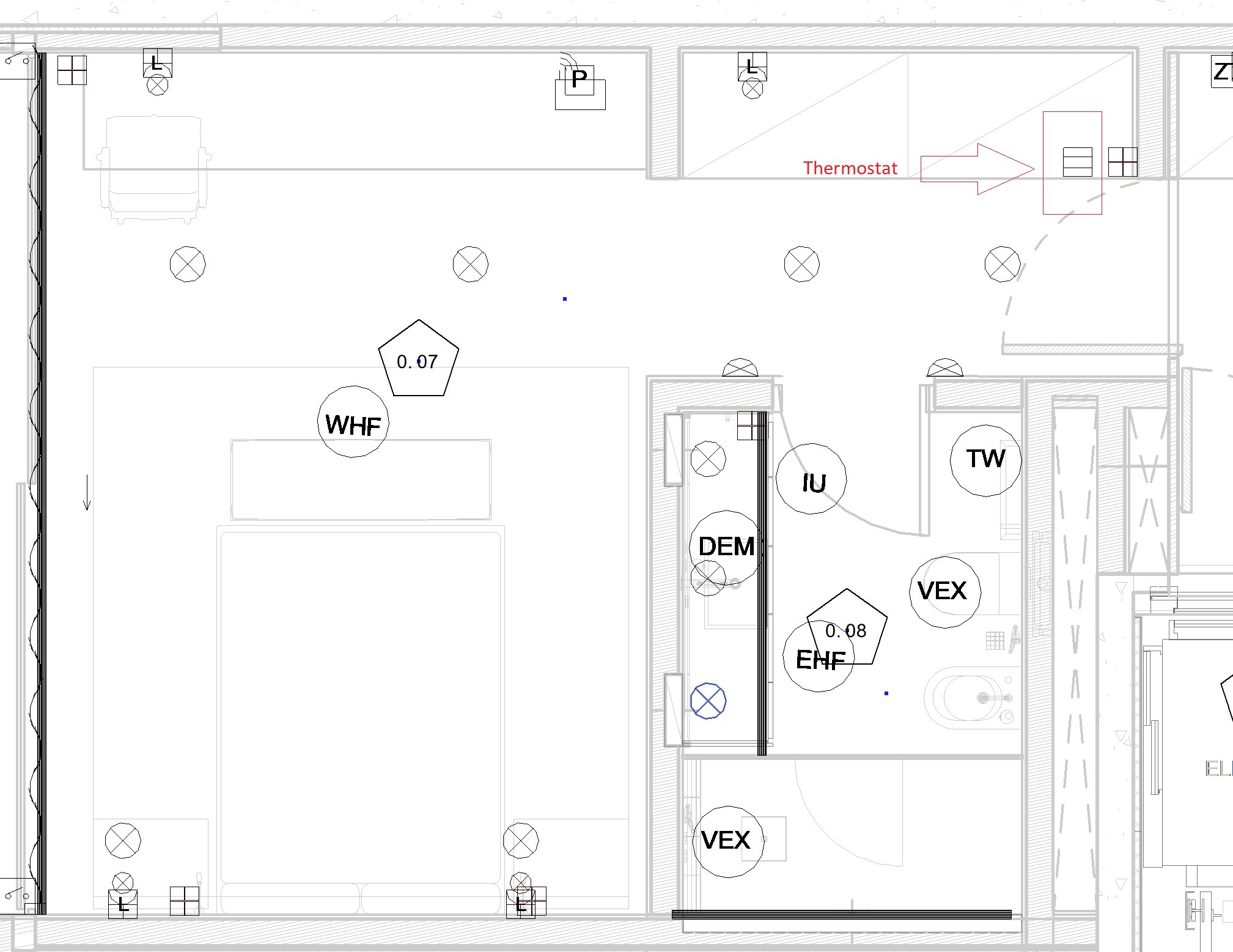

Im runing a dynamo script where i need to get the level and division number of the all elements in revit project.
Everything works fine, except for one element ( Thermostat) , where to location outputed is clearing not where it is
i write this example code see display 2 ways of how i get the level and division number (both give the same result):

the output is this:
-1
-1 | 4
And the location should be level : 0 and division: 7
This is a strange error , because the location in all elements is correct except on this one, why?
When i run the multi-category schedule, I get the correct level , which means the problem is in the dynamo python function, right?
Here is a screenshot of the multi-category-schedule:
Does anyone have a clue of why is this happening, or have a solution?
