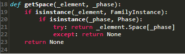

Here is the final code for getting the space:
