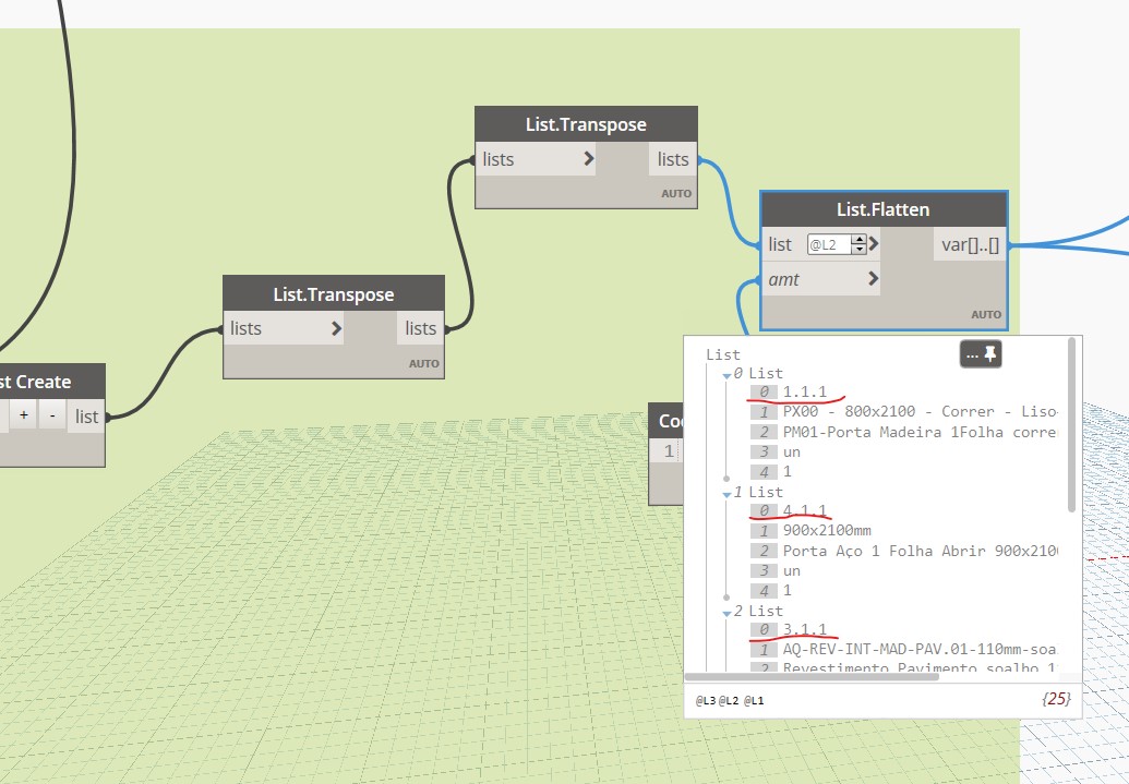

I’m trying to sort a list by part of the sublist value in this case the first column wich has numbers in it.
In this case I joined 3 schedules from revit and then exported it to Excel but i would like to reorderit by the first column number.
Any suggestion would be appreciated!
Thanks a lot.
Daan

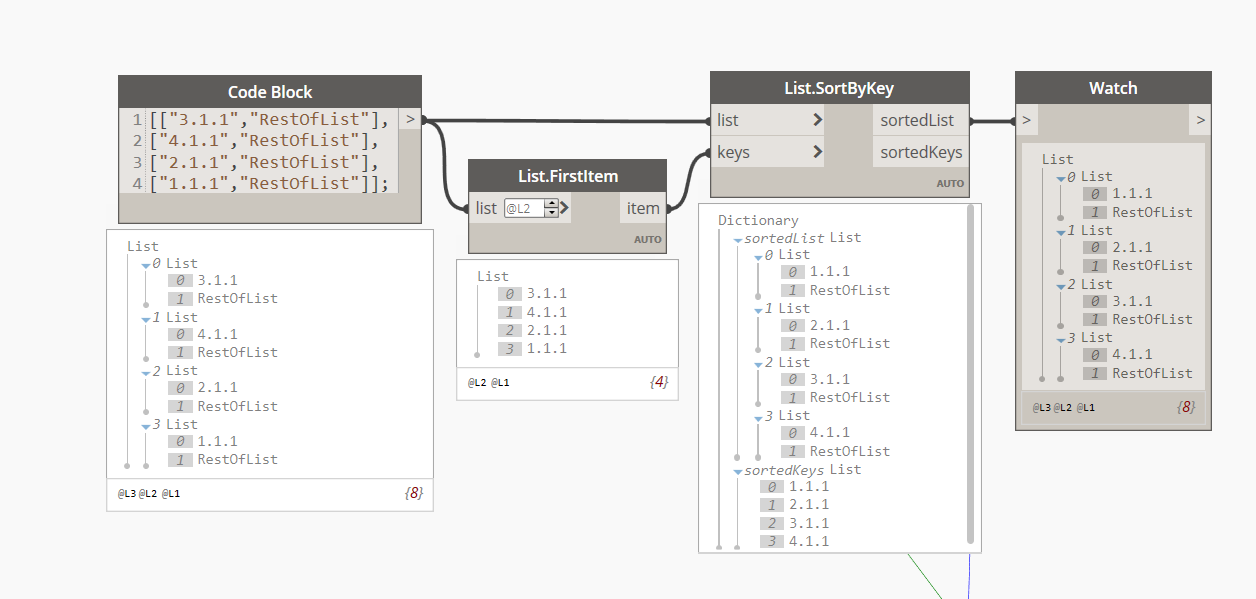

Hi @JI_NGS ,
The List.SortByKey node is exactly what you need for this

3
@Daan
It Worked just fine!
Many many Thanks!
