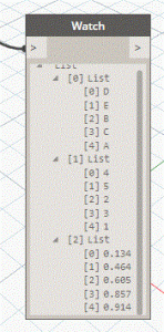

I am a new dynamo user and it didnt take me long to get completely stuck. This is probably a rookie question but I couldn’t find an answer anywhere on the web.
So suppose I have Three lists -“Room name”, “Room number” and “Room area”. I am doing a basic Revit to excel export. The exported data is often mangled so I need to sort the whole list of rooms by number, area or some other parameter.

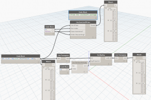

So basically I need the list in image 1 to be sorted as in image 2 (sorted by the figures in list 2 in that particular example) .
