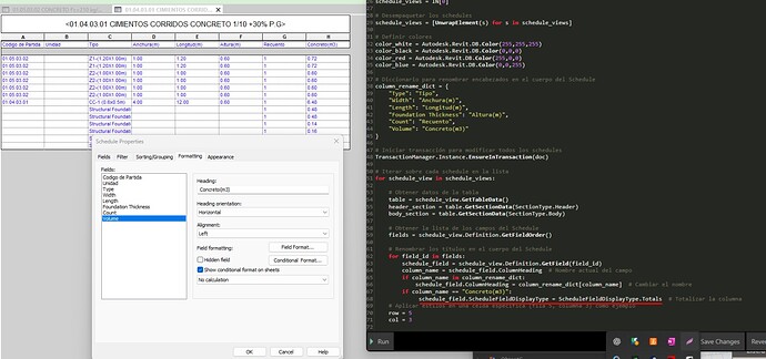

Hi, someone could help me with my code
works correctly but when I want to generate the totals in the “Concrete(m3)” column it does not generate anything
I would like to know if the ScheduleFieldDisplayType method call is well structured.

The property of the field is DisplayType, which takes an argument of one of the ScheduleFieldDisplayType enumerables. So it should look like this:
schedule_field.DisplayType = ScheduleFieldDisplayType.Totals

still does not change the value to “calculate totals”.
That looks to be the same code you had before. You’re using ScheduleFieldDisplayType in both locations but that’s not correct. The property is just DisplayType.
You can check this by returning schedule_field.DisplayType to see the current selection since it’s a get/set property.
