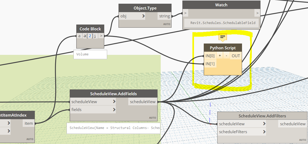

Currently, I am trying to automate the process of making schedules in Dynamo. Creating the schedule, adding fields and setting filters is going fine. The formatting of the schedule is working to an extend. I would like to change the setting from ‘No calculation’ to ‘Calculate totals’ via Dynamo (see image below from Revit schedule settings).
I am able to adjust some of the fields with nodes from Archi-Lab. The code Archi-lab used is copied below. I am able to make small adjustments to the script, mainly removing some options. Unfortunately I can’t figure out how to adjust the script to set it to ‘Calculate totals’. Is it possible to adjust this field and where can I find the correct statement to change this field?

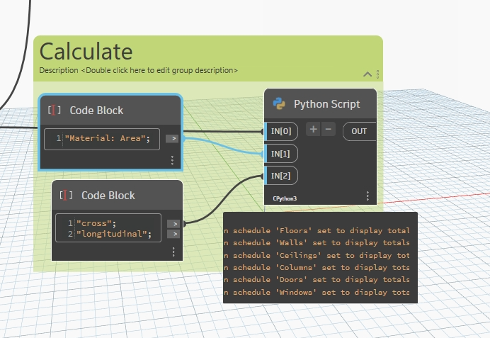

Hey can you please help me in the above script.
What are the inputs ?
IN[0] as ScheduleView
IN[1] as String
Add Lacing
clr.AddReference("RevitAPI")
import Autodesk
import RevitServices
# Inputs
schedules = UnwrapElement(IN[0]) if isinstance(IN[0], list) else [UnwrapElement(IN[0])]
colNames = IN[1] if isinstance(IN[1], list) else [IN[1]]
mode = IN[2] if len(IN) > 2 else "longitudinal"  # Default to longitudinal
# Ensure inputs are lists
if not schedules:
    OUT = "No valid schedules provided."
    exit()
if not colNames:
    OUT = "No valid column names provided."
    exit()
# Output list
results = []
# Function to process a single schedule and column name
def process_schedule(schedule, colName):
    schedDef = schedule.Definition
    countParameters = schedDef.GetFieldCount()
    for i in range(countParameters):
        paramName = schedDef.GetField(i).ColumnHeading
        if paramName == colName:
            field = schedDef.GetField(i)
            field.DisplayType = ScheduleFieldDisplayType.Totals
            schedDef.ShowGrandTotal = True
            schedDef.ShowGrandTotalTitle = True
            return f"Column '{paramName}' in schedule '{schedule.Name}' set to display totals."
    return f"Column '{colName}' not found in schedule '{schedule.Name}'."
# Longitudinal mode: Pairwise processing
if mode.lower() == "longitudinal":
    for i in range(min(len(schedules), len(colNames))):
        result = process_schedule(schedules[i], colNames[i])
        results.append(result)
# Cross mode: All combinations
elif mode.lower() == "cross":
    for schedule in schedules:
        for colName in colNames:
            result = process_schedule(schedule, colName)
else:
    OUT = "Invalid mode. Use 'longitudinal' or 'cross'."
    exit()
OUT = results
