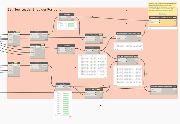

Does anyone know of a node that sets the Room Tag elbow position or have some python code to help me create a custom node to do the job.
I am using Rythms Tags.SetLeaderElbowPosition node (thats great) but it doesn’t work for Room Tags:
Any help would be much appreciated.

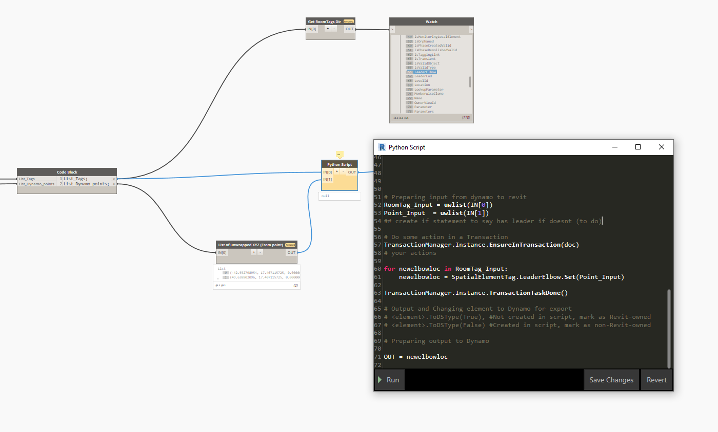

Update: I am now trying to create a node that will work with the SpatialElementTag Class (Room tags) but am struggling with setting the LeaderElbow property. Would anyone be able to point me in the correct direction:

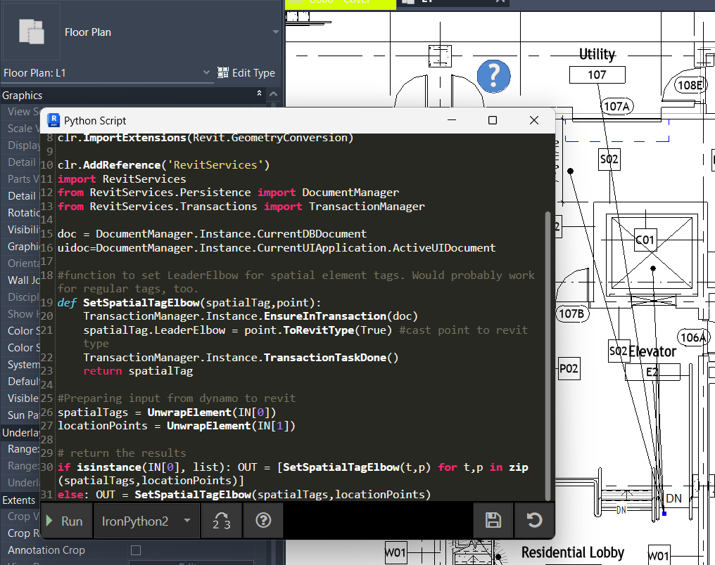

This should do it. Or at the very least offer some ideas.
clr.AddReference('RevitAPI')
import Revit
import RevitServices
uidoc=DocumentManager.Instance.CurrentUIApplication.ActiveUIDocument
#function to set LeaderElbow for spatial element tags. Would probably work for regular tags, too.
def SetSpatialTagElbow(spatialTag,point):
This file has been truncated. show original
In my screenshot below I just set them both to 0,0 for testing.
