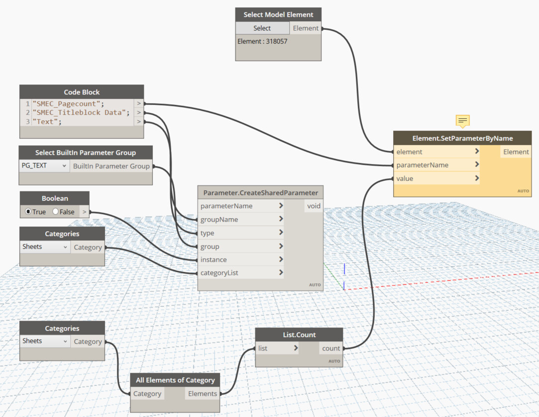

Hi all,
I am a “newbee” to Dynamo and I need some assistance.
My intention with this graph is to automatically count the number of sheets used in the project, and then to read the value into a “pagecount” project parameter. I am hitting dead ends with this error.
Greatly appreciate the assistance!!
Hi Mauritz,
For future reference, please start a new thread.
See if this workflow helps?
Hi Kevin,
Will do next time.
Did exactly as per your graph. Still returns this.
Is this perhaps a setting issue?
the warning states the storage type is not a number, try add object to string after list.count and use that output to value.
In addition, make sure you have a project parameter setup under “Page Count”, in my case above, I did it as a instance parameter.
Thanks Kevin. That solved the problem.
