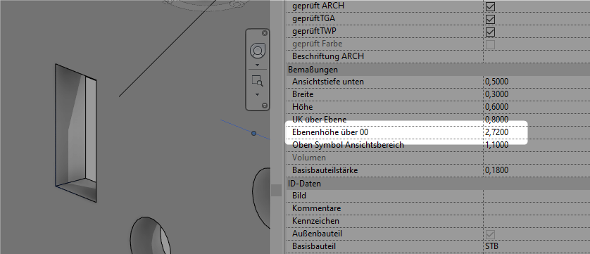

		p = i.LookupParameter("EbenenHöhe über 00")

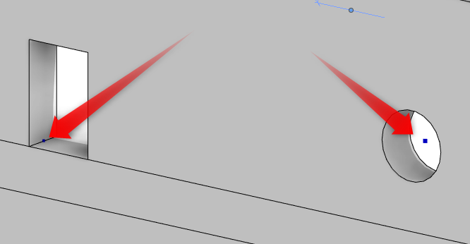

just taking the locationPoints get Z Value and set the shared Parameter insteat of calculating!
because i have assets, rectengular and circle openings… is it possible this way ?
grafik
the task is just get → Set

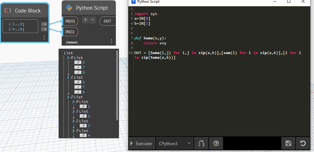

You are summing before you zip, which I don’t think is your intent in this line:
Apsoluts = [i for i in zip(Sum(Hosts,Offsets))]
Try this instead:
Apsoluts = [Sum(i) for i in zip(Hosts,Offsets)]

  • get locationPoint.Z
  • set the Parameter
I think thats better than any location, but i am struggeling with units and negativ values…

		target_para = opening.LookupParameter("EbenenHöhe über 00")
