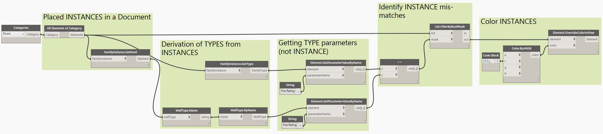

@Raja Have a look at this. (twitted by @Zach_Kron)
Thanks a lot @salvatoredragotta, i didn’t know that “set parameter value by name” could get this job done. I still have some more questions regarding it but since this is going off topic I will start a new post.
