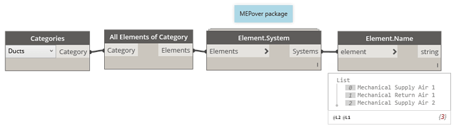

Do you have any idea how would I additionally filter element based on MEP system (so Category + Level + Family Type + System (like Exhaust air, or similar)?
Best regards, Branimir
If you download the MEPover package there is a node Element.System that you could use, with the same structure of filtering you have done with Category, Level and Family Type
from where to get this “Element.System” custom node?
Hi @rafaybukhari,
See the little tag above the node :wink:
