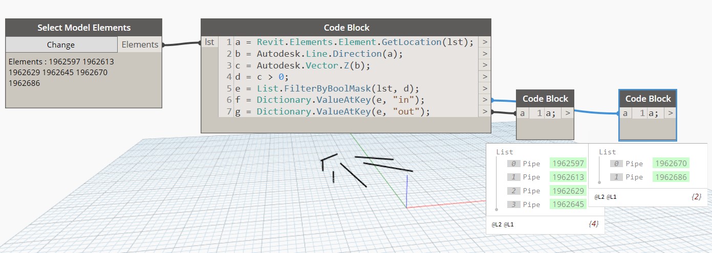

Hello here is a way for sorting vertical versus horizontal

here are the pictures for better understanding
Capture d’écran 2022-04-13 142201
programme sovetek essai à travailler_2022-04-13_02-22-38
I’m on Revit version 2020.2.8 in education mode
Capture d’écran 2022-04-13 142347
Thank you for the time given :wink:

Hello @rashidsohail27 and @christian.stan …here is a way with ootb hope it helps…
PS when we need filter by bool mask as designscript the output is a dictionary
pipe designl.dyn (8.8 KB)

Use a similar approach to before, but instead of just looking at the Z value of the vectors look at the X value. If X is less than 0.5, it will be B, if it is not vertical and is greater than 0.5 it will be C.
