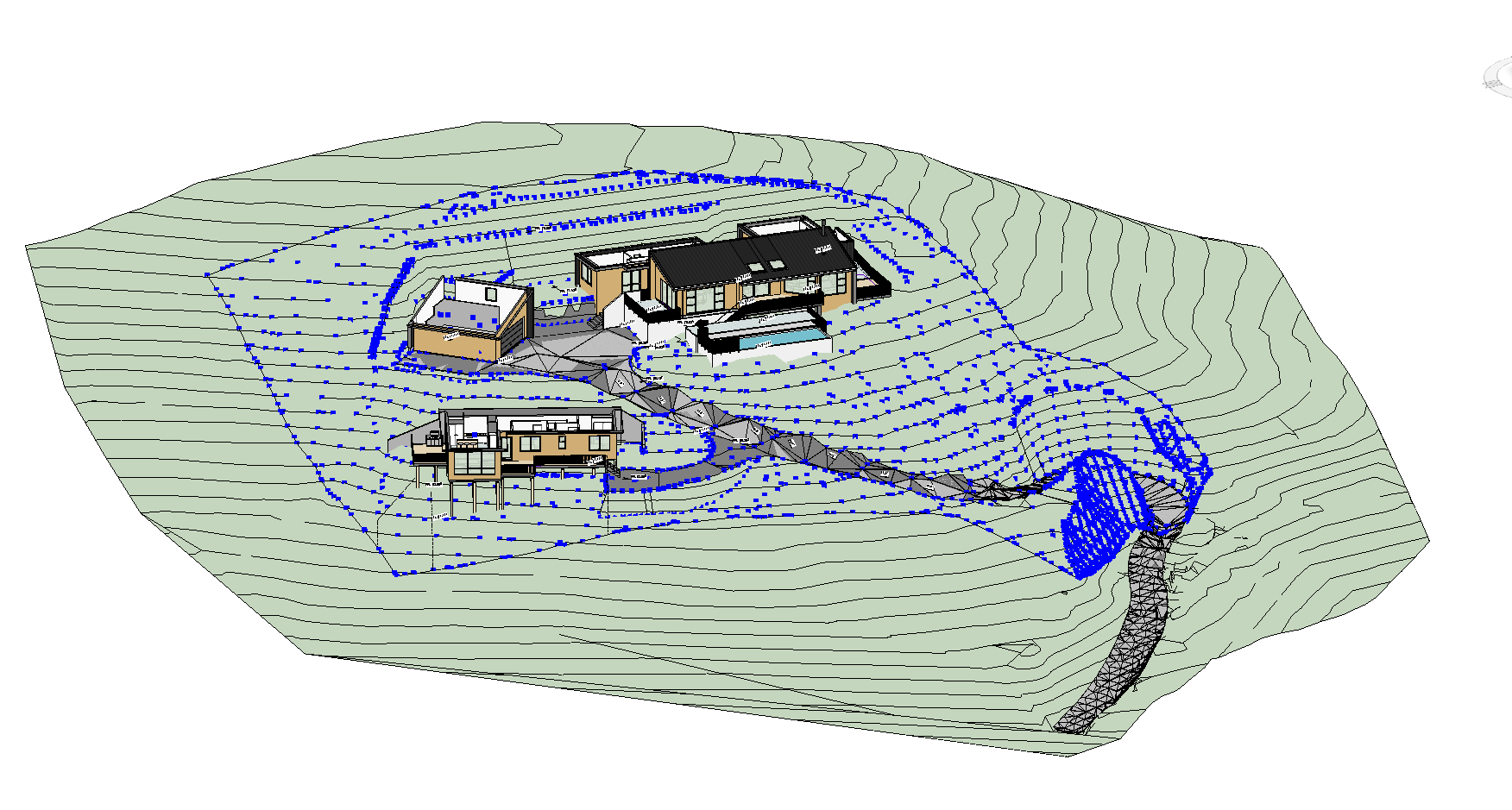

Currently I am finding the best way to edit Topography for houses on steep slopes is to use a combination of building pads under the buildings and flattened topo-regions for the surrounds.
What I want to know is: - Is it possible to select every topo-point at a specific height with Dynamo (or Revit) so that I can change them en-mass when the building height is changed?
Thanks and Images below :

Because what I am wanting to do is select the points within the topography which are representing a graded region, so that I can change them en-mass.
How can I select points within a topography through dynamo? Dynamo selects the topography, it reads all the points but it doesn’t select them.

After you obtain the points in Dynamo, you can edit the subset in Dynamo (up or down), place a new topography via Topography.ByPoints, and then delete the old topo. This would likely need to be done before you do any work with pads and split regions as they would not transfer over.
An alternate solution would be to manually edit the topography in Revit-- in an Elevation view or 3D view oriented to the side, do a window select of the points at the elevation you desire to change, and then change them. You could deselect any unwanted selected points by further refinement from other view angles.
