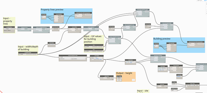

Have you used a Remember node to cache the data?
Yep.
Can you show a screenshot of your graph then?

@Alien as far as I know, you cannot use the select in Revit buttons with Generative Design For Dynamo For Revit. It is only available in Generative Design for Revit. To change your selection you will have to go back to Dynamo for Revit, update the selection(s), and export to Generative Design for Dynamo for Revit again.
Note that if you don’t do a save as in there this also fails.

No, I mean you need to save as a new dyn and export the graph again for each revised selection. Those buttons will not help you until you’re in the Generative Design for Revit add-in which requires 2021 (or for your case 2022.1). Watch for the product update closely and hound your IT to roll that you quickly.
