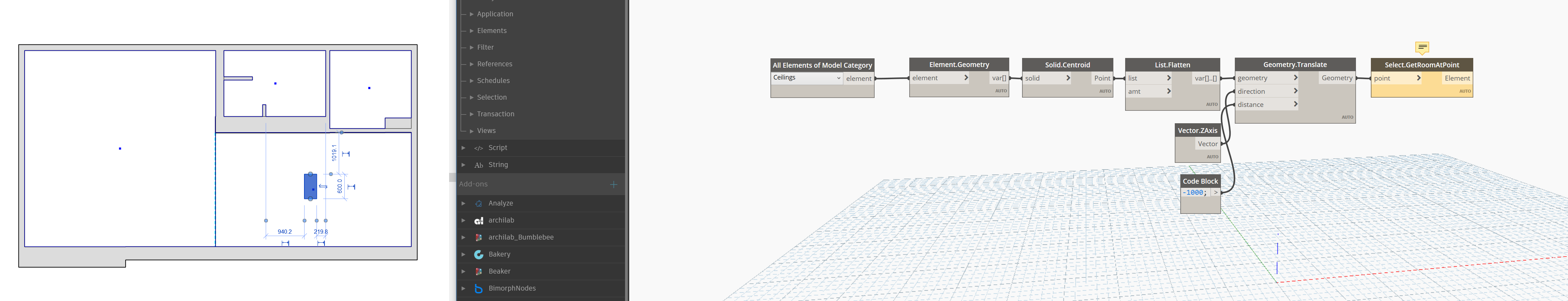

Here is my dyn files (I can’t upload rvt because the file is too big):
GetRoomAtPoint-Problem-02-05-19.dyn (12.4 KB)
It seems to work when there is not a wall/column or something else in the way of the point. There is a probably a workaround in this situation that involves using multiple points but it would be good to know precisely why this error occurs for future reference.
Not working:
Working:
Just as a way of explanation. I think that its pretty logical to assume that the GetRoomAtPoint operation fails when the point falls onto a Column object. Columns are Room Bounding, what that means is that column volume is removed from the volume of the room. Basically there is no Room where there is a Column. Hide the column and you will see that there is a void for the Room object. If there is no Room the node will not be able to select it. Makes sense?
With column:
With column hidden:
That makes a lot of sense. I got it working with multiple test points in the space, but it might be easier to make columns/walls which fall within a room not ‘room bounding’ so that rooms are easier to detect - I will try next time I’m at my PC. Thanks for your help!
Or get the room’s bounding lines and see if it is a donut (or worse Swiss cheese), then remove said donut / cheese creating elements automatically, test your one point to get the room, and then re-enable room bounding on the donut / cheese elements…
