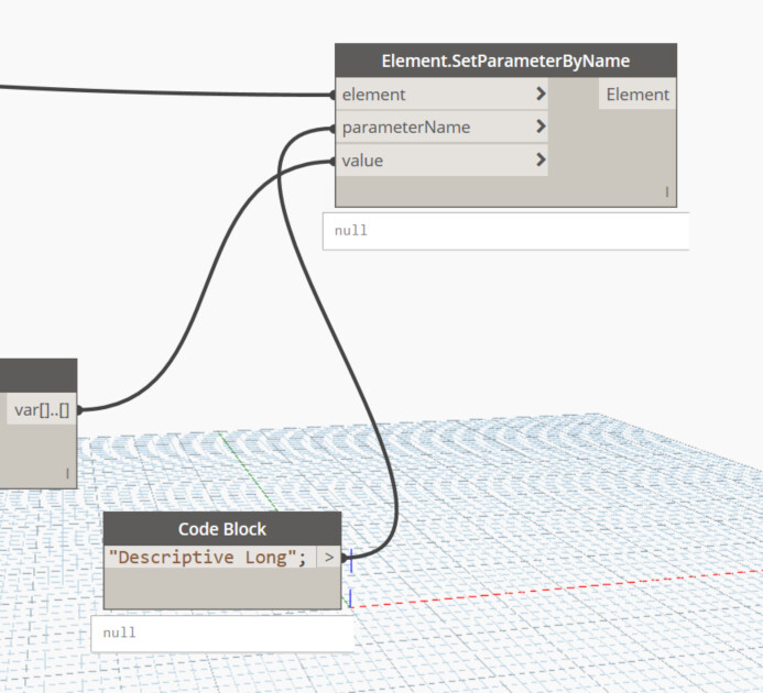

I put together a script but I’m not seeing the output in my family. I’ve ran the script and haven’t gotten any errors so I’m not sure what the issue is. Anyone else run into this issue or have any guidance?

Thank you. Can you show that with the node previews pinned so we can see the outputs? Specifically the individual parameter values, the final combined value, and the final output after applying the new parameter values. Is the new parameter, Descriptive Long, a type parameter or an instance parameter?

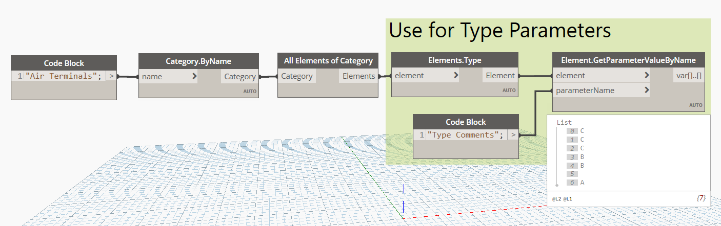

Next, I took a quick peek into your family file - all of the referenced parameters are Type Parameters, not Instance parameters. You’ll want to pull the Element Type for this instead of the Element.
Lastly, here’s another way to streamline your script:
I’ve made the Descriptive Long parameter a Type. Nick, looks like all the previews are reading “Null”.

This is one example of going from instance level to type level, though the type list will have duplicates. It’s probably fine to Get/Set Parameters this way for most projects but for a really large dataset you’ll want to grab the Type Elements directly to keep the list short.
As @Robert_Younger mentioned, you’ll need to get the FamilyType to query type parameters. Are all the nodes showing null? A codeblock string shouldn’t show null. Can you confirm you don’t have a command running in Revit?
