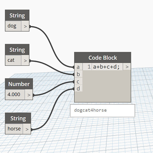

To join parameter values just create a code block that says a+b+c+d
But you will have to convert numbers to strings first, if more then one number is in your values that is.
