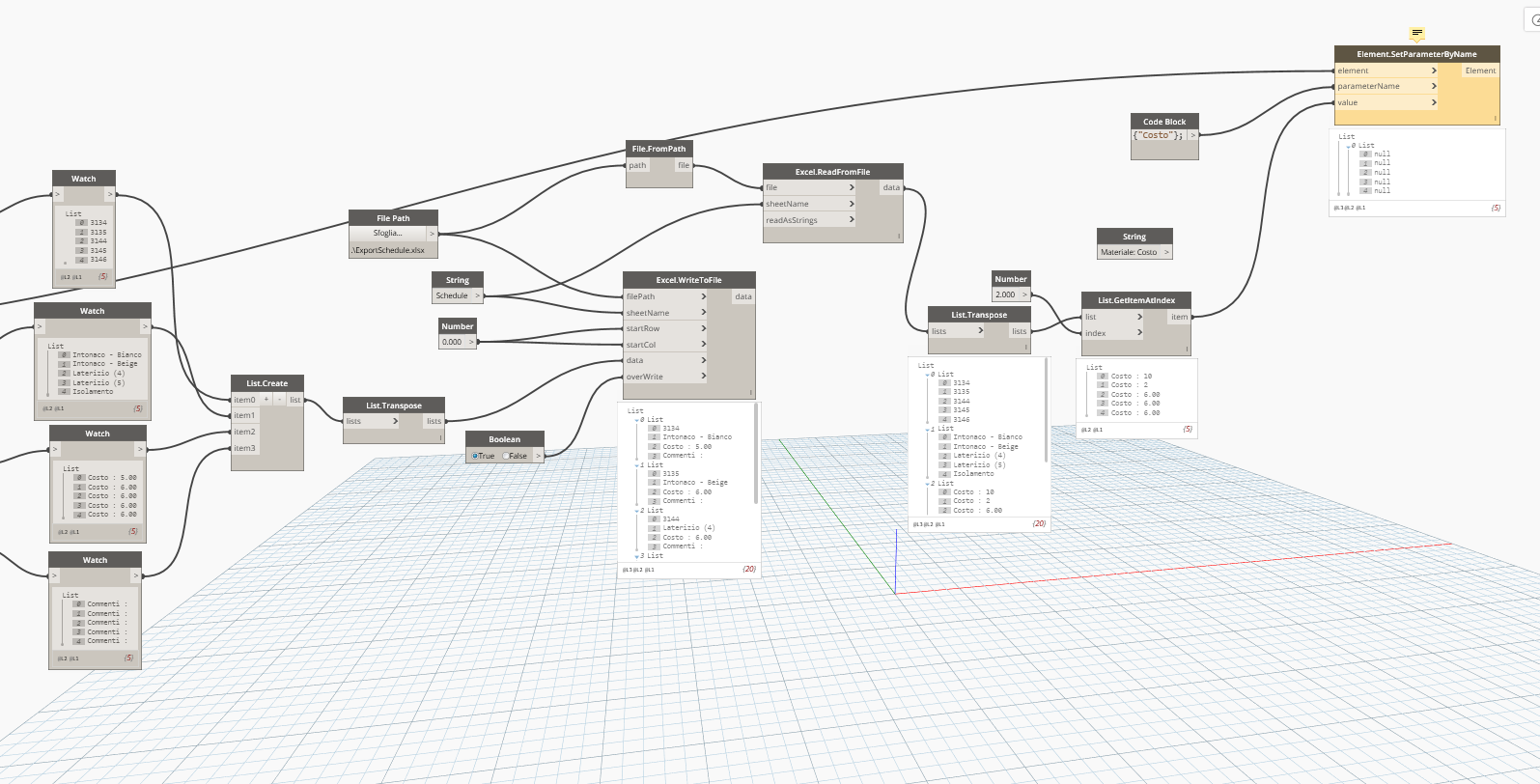

Ok I did it but I have a problem.
If I change the parameters in the Excel file Revit assign just the first number (overlined in yellow) at all the materials. Someone can help?

I tryed to do it but it still not work
Something wrong?
It looks to me you are trying to write a string value (costo : 10) to a parameter that requires a value. You should try to filter the value from your sheet. And try to show the warning you’re receiving from the set parameter node.
I did it but it have the same problem (it copy the first value to all materials)
Try using list levels, right now you’re choosing the 2nd list (which contain your five 1’s). If you use list levels you could get e.g. all values on the 2nd location in each list.

Firstly you should be careful both reading and writing to the same sheet of excel in the same graph… This can cause issues for large data-sets…
Also what changed from your previous post, where it didn’t assign the same values?
Thank you it works.

I would probably have one graph for writing the data and one for reading and assigning data back.
But if it is to be kept in one graph then I would use a codeblock for delaying the data from being read until you are sure that it have been written, the codeblock content could be:
{waitfor,pass}[1]
waitfor is the data that is waited upon, and pass is the data that is passed once both data values have been received.
