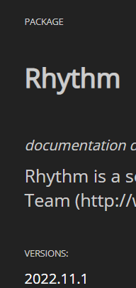

I’ve removed 10.2 and installed 11.1, but i’m getting an unresolved node for the titleblock types node.
I checked in the library also, and it appears quite a few nodes not loading
11.1 library image below
10.2 library image below:
I uninstalled and reinstalled again in case it was my download or installation but i think maybe they’re missing from the latest version?
