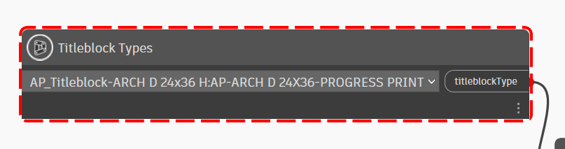

I have just run across a node that is highlighted by monocle as a custom node, but I can’t figure out from which package. The name is Titleblock Types. It’s a simple list of all Titleblock Types in the current model. It outputs a single titleblockType.
The Workspace References pane has an X beside Rhythm, so it makes me think it’s coming from (or came from) Rhythm, once upon a time. I’m not seeing it in Rhythm’s node list anymore though. It also doesn’t have the small rhythm logo before the node name like other Rhythm nodes.
Anyone know where this node comes from and how I may be able to get an updated version of it?

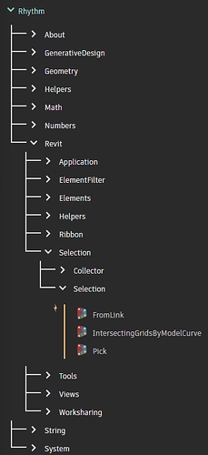

Do you see the node in the category? For me, the node seems to work, but only because I started with an older script. I can’t create a new instance of it in a new script though since it’s not listed in the package contents anymore.
This is all I see for the contents of that category under Rhythm:

I’m looking on the Rhythm github page, but the last and only release I see is 2022.6.1. So I can’t see release notes for when or why these nodes were removed. If they’re deprecated, is there an OOTB path I should take to replace them?
Not that you’re under any obligation to document any of this stuff with a free and open-source package like this. I appreciate your hard work on this. :slight_smile:
Ouch. Yeah, 9 nodes compared to 1. :grimacing:
UI nodes have been increasingly difficult to maintain, so for now they are gone. But I am working to get them added back.
