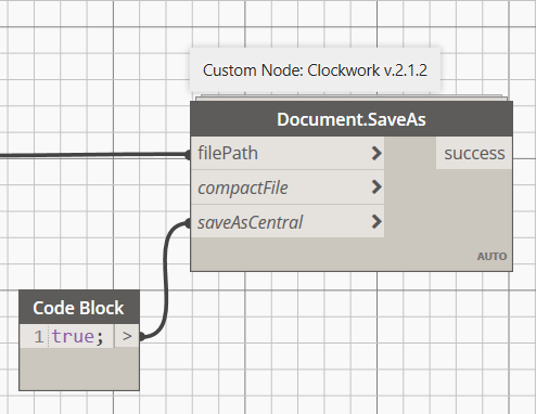

For me, I was having trouble trying to save. I set saveAsCentral to true and everything seems to be working so far. Maybe this’ll jog some ideas.
