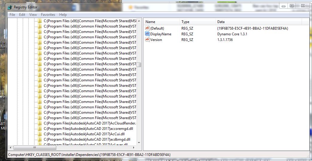

Anything in the registry?
I found dynamo core 1.3 on registry
what should I do?
With that one: nothing. It’s the 2.0 keys we’re after.
