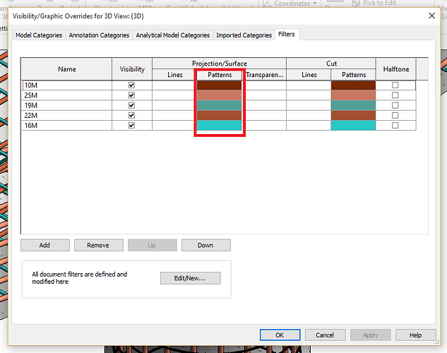

I have been trying to retrieve Color patterns. I have seached this forum and have not yet found any post. I greatly appreciate any help or guidance anyone has to ofer. This is image.
You can achieve this with a slight modification of the code found here.
The reason why you are getting -1 is because the colours aren’t valid.
You could try this. It gets all the filters assigned to each view and then gets the filter overrides projection line colour and returns a Dynamo colour object if its valid:

No worries, please mark this topic as solved if my reply has provided what you needed.
