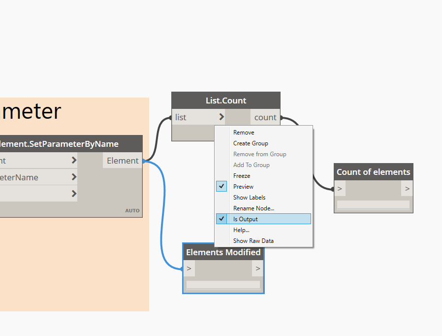

I thought that all you needed were Watch Nodes that either werre Renamed and/or ‘Is-Output’ toggled on.
But this isn’t working for me.
What am I doing wrong?
. Capture4
I believe only named watch nodes are outputted to player.
I did that if you look at the image.
I did that.

So either it’s something with your setup, or it’s a bug…
Perhaps do the old turn it off and on again, then maybe give us a screenshot of Player with the inputs and all? And maybe your Dynamo / Revit specs?

Your current selection is the count node. Select the watch node and then right click and let us know what it says.
I deleted the Watch Nodes, then, renamed and toggled Is Output on the Watch nodes and refreshed Dynamo Player.
Output to the user shows up now as it should.
