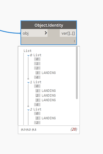

I have a list which looks something like this.
What I am trying to do is replace items which are consecutive and based on a condition (= “LANDING”). So in this scenario, only list 1 should change and be:
0
1 Landing
2
3 Landing
4
What would be the logic to do this? I can get the index of similar items but to determine if these indices are sequential and use that to drive a replace by condition I’m not really sure. I suspect it’s a problem for Python?

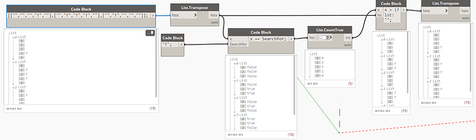

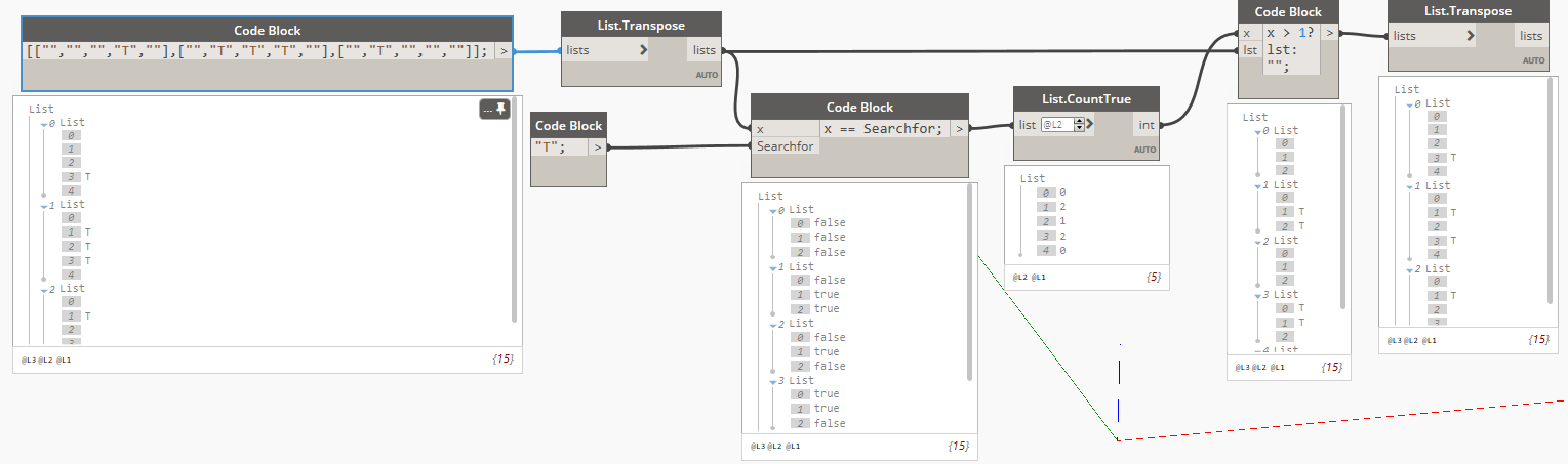

Just for the fun of it I gave it a crack using nodes/codeblocks… how would this work?
wow :star_struck:

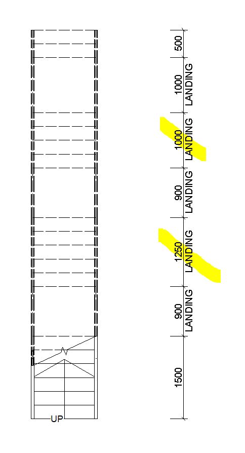

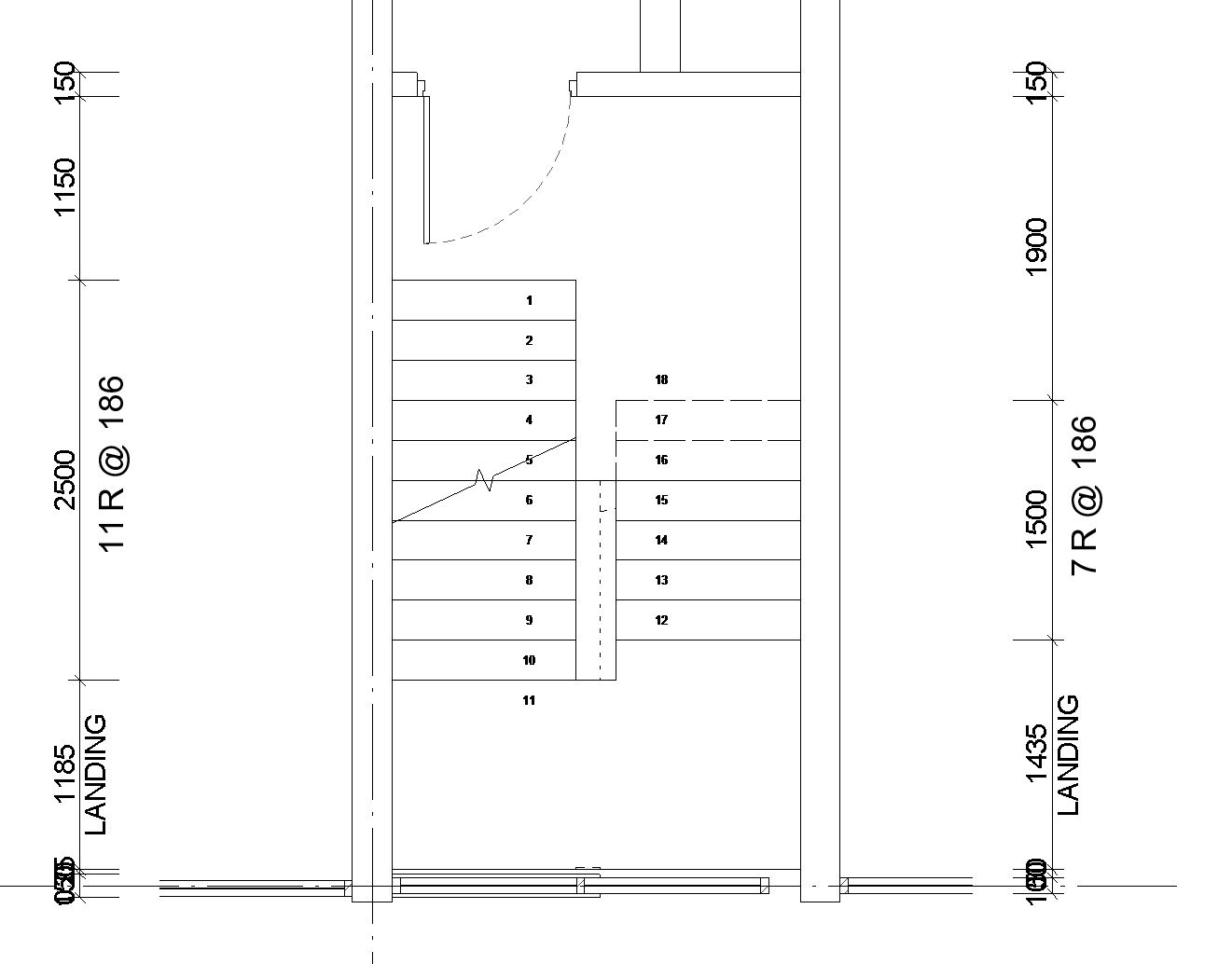

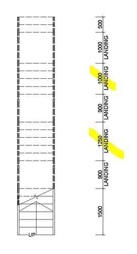

Sorry i should have been clearer. The script is dimension through a stair run to create a dimensional string. The stair could have any number of risers so the list length will be variable. For each run (list) there will be a variable amount of reference faces (sub lists).
In order to modify the ‘below text’ I’m preferring the landing face and removing the riser face in case it is co-planar. Using Rhythm I can get the element the dimension is hosted to. If the dimension segments is pointing to TWO landings, that it is a landing, else it is something else so no need to over ride the text. It is pretty straight forward in this scenario.
However here, the list would be:
  • stair
  • landing
  • landing (to be overwritten)
  • landing
  • landing
  • stair.
Using my methodology shows the below text incorrect. So the rule I guess is that, if there are consecutive instances (“Landing”), replace with “” in a false/true sequence. I think that’s right…I’ve been looking at this for too long!
So basically what you want is there to not be any consecutive LANDING in a single list?
I too would like a little further information :slight_smile: I don’t quite get what your initial input is and what your expected output is etc. :wink: If I understand that you only want to keep lists which have only one value etc change the “>” to a “<” in my post. But guess it is not that simple.
Does this help?
@kennyb6 yes I believe so.

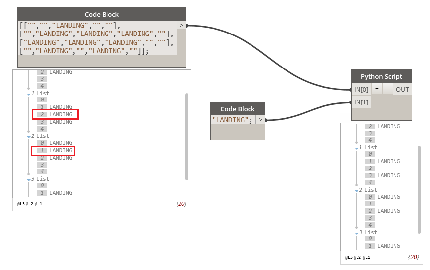

Is this what you mean?
The items in the red box should be removed because it is consecutive?
This is the python, let me know if it works.

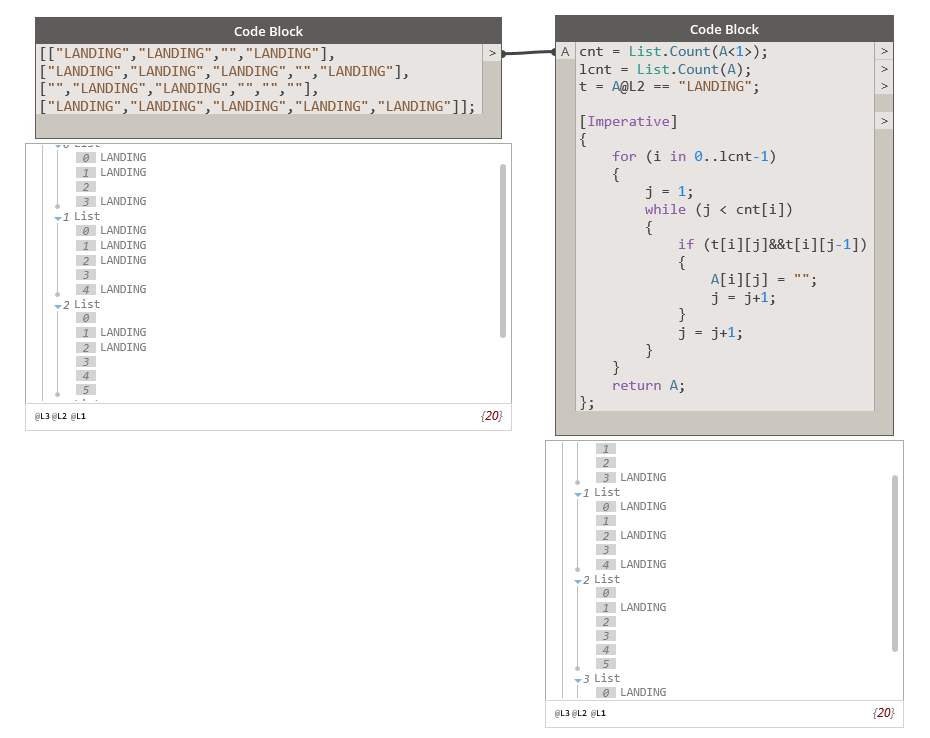

This oughta do it with no Python and just one node :sunglasses:
Had to resort to a while-loop because the for-loop won’t let me manually change the counter…
