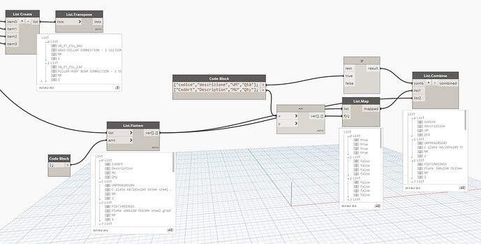

I have a list which is populated by placeholder text and I wish to replace such text by other values later in the script.
I followed this script by @Dimitar_Venkov and I succeed with a single replacement item.
The point is now I have a list of items to replace and I wish to substitute one of them at the time.
I mean: 1st occurrence shall take 1st item on my “replacement list”, 2nd occurrence shall take 2nd item of my “replacement list” and so on.
I post a picture of my graph for better understanding, hoping someone could shed a light.
The code block shown the “static” replacement list which works feeding the same value for all the occurrencies.
On the left, the list.transpose contains the actual values of my “replacement list” I want to replace.
Thanks in advance.
Cheers.

Hi @Kulkul, Hi forum,
I tried with my approach but I’m stuck with my Python code (see image below).
Can you please provide me support?
Thank you.
