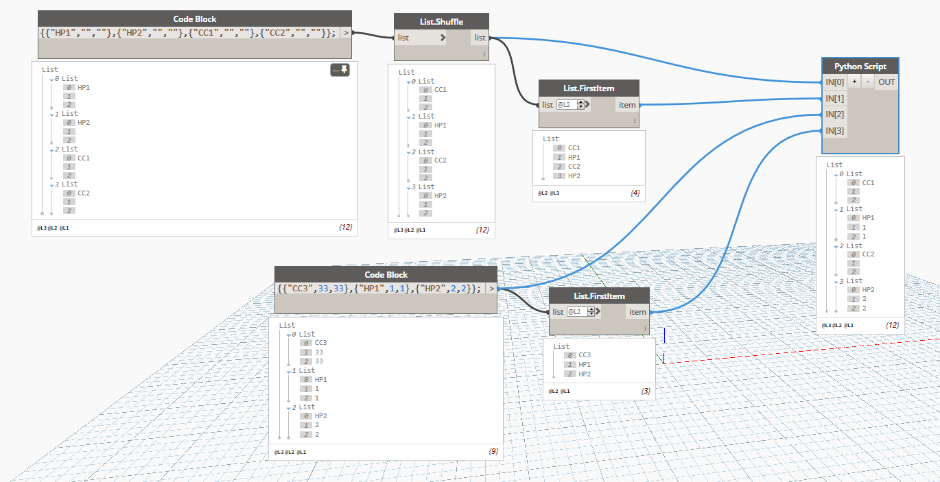

Hi guys, I am having trouble replacing certain items in a list. In the example shown below, I am trying to replace items in List2 if the same item in index [0] of List1 is found. Appreciate your help!
List
Easy with Python :grinning:
data=IN[0]
dataFirst=IN[1]
replacement=IN[2]
FirstList=IN[3]
a=[]
b=[]
for ind, item in enumerate (dataFirst):
	try:
		a.append(FirstList.index(item))
		b.append(ind)
	except:
		pass
for i,j in zip(a,b):
	data[j]=replacement[i]
OUT=data
