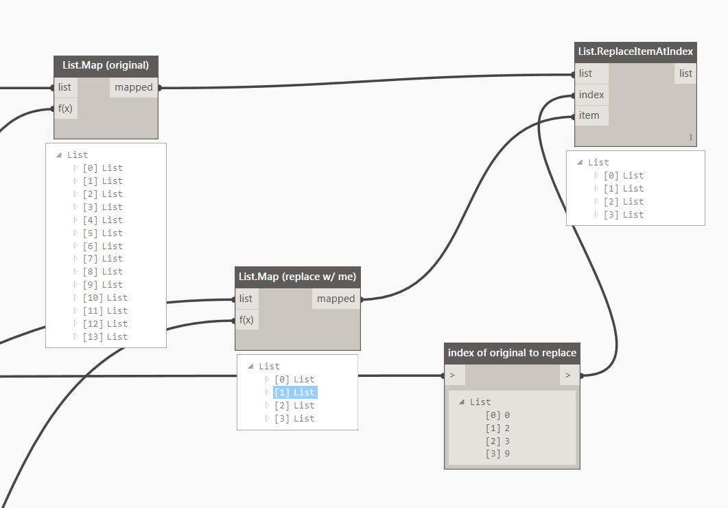

Two lists of differing lengths where each element in the list is another list, and a list of index values whose length matches the smaller list. I want to replace items in the longer list, with items in the smaller list based on the list of index values. I assumed List.ReplaceItemAtIndex would do the trick but no. Instead of replacing items in the longer list at the top level, it drills down to the sublists and replaces items there. The list at the end should be the same length as the original list not the length of the smaller list.
I can get close, I think, with Python, but I’m getting an out of index error (which makes sense… I just don’t know how to resolve it).
