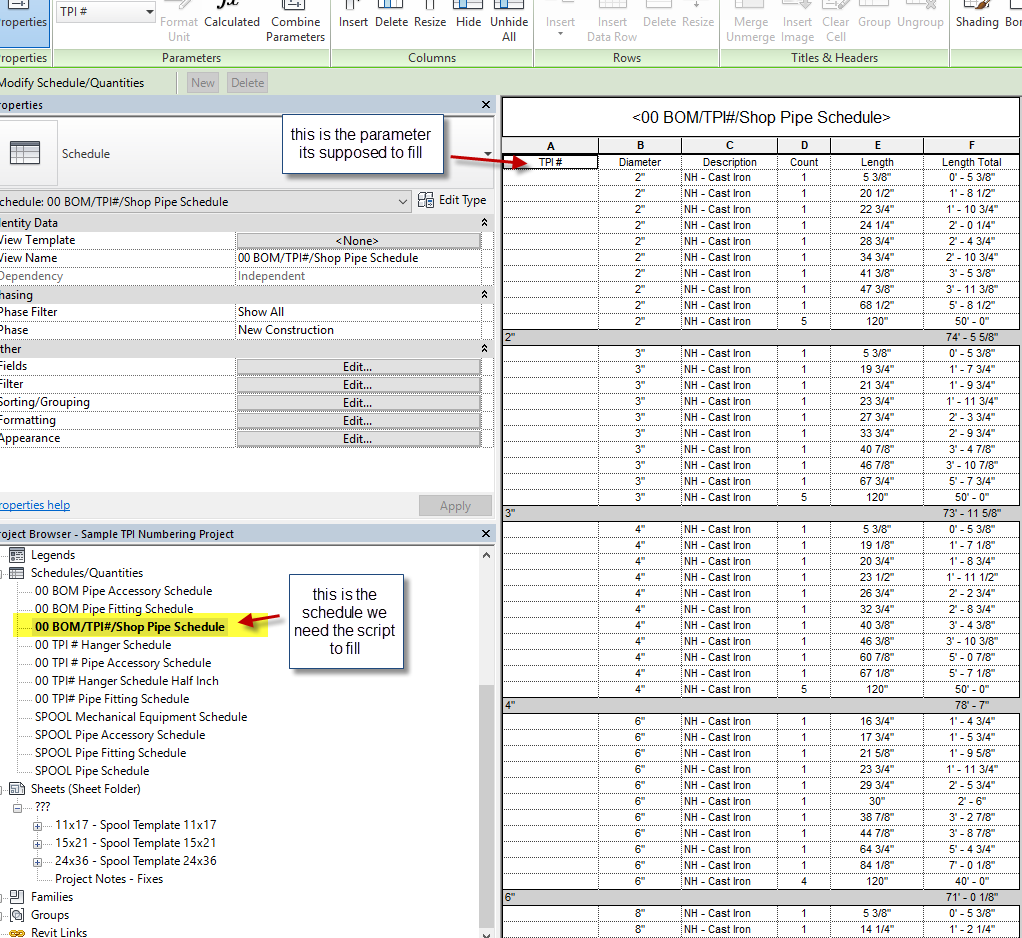

this is where i think the break is for some reason its not gathering the lists?
Cannot say much from that… Show the entire graph, pin ALL previews and export an image where we can see information of ALL nodes using the camera icon…

here is the capture through dynamo with all nodes pinned let me know if this is what your asking
The problem looks to be that your searching for something like ‘‘NH cast iron’’ but your values are in fact ‘‘NH - cast iron’’… This results in empty lists making the graph fail…
