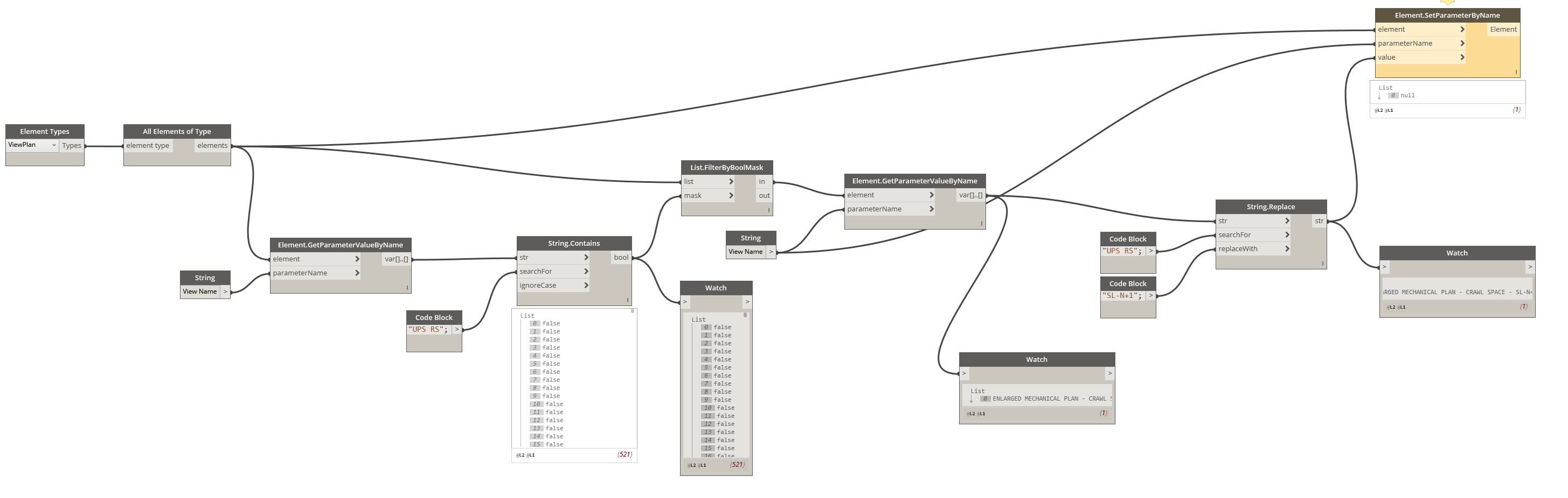

The error I says there is no parameter found by that name, which is confusing because I use the same parameter for upstream and it works at that point.
Any suggestions, please?
Not sure if this is the problem but you’re feeding your unfiltered list of elements into the SetParameter node after filtering.
That was it. Thank you so much!
