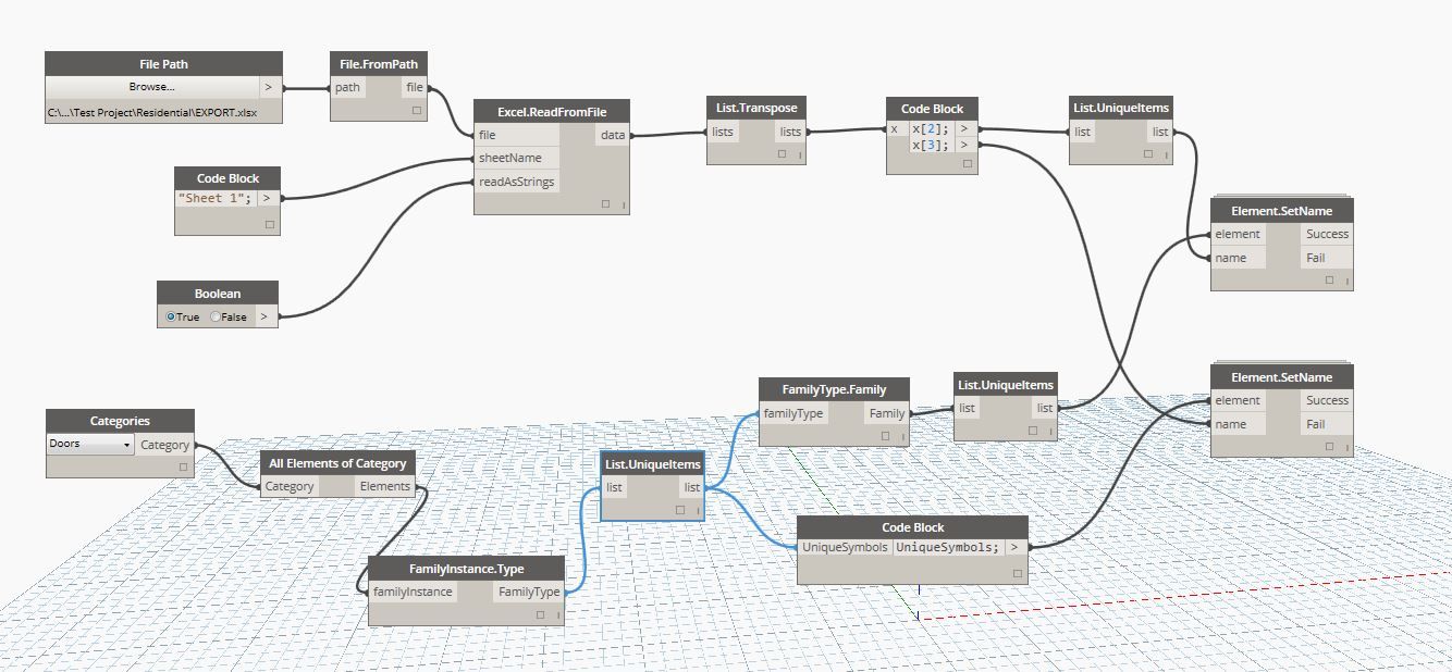

Here is the program I used to export the family name and type name to Excel
And this brings the renamed families back to Revit (Sorry, as a new user I could only post one image)
http://i577.photobucket.com/albums/ss215/Jozi_E30/Dynamo/02_Import.jpg
I’ve hit a snag where I get an error when I try to run the above on system families, user loaded families are no problem at all. Is it possible to use the same programs to pull system familie names from Revit and rename them in Excel and then push this back to Revit the same way as the above works? I’ve tried swapping out some nodes but my knowledge on how it works is still limited and I can’t seem to get it to work or understand the errors that are produced.
