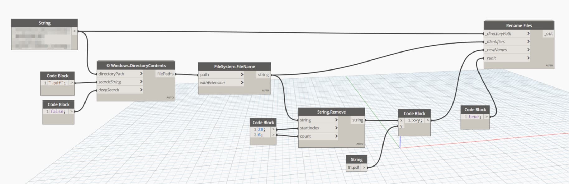

Probably a silly one, but i am trying to rename some PDFs with dynamo and something seems to be wrong - or i might miss something ![]()
You can see the script below
Thank you al lot in advance! Cheers

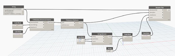

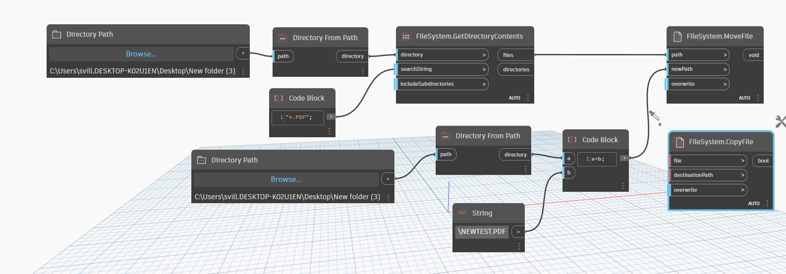

hI @andrea.dilisa95 You could try ootb copy file or move file, i would just say for move files or directory handle with care as there are no undo and its really do what it say ![]()
