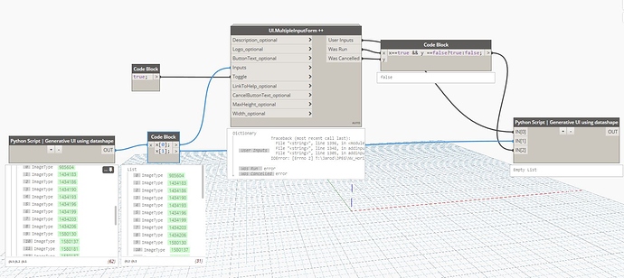

Aw man I was so excited to try this when I got in but it failed as well. The nice thing it did was find all the jpegs without me pointing to a directory. but then it did not reload them. I did however try to incorporate the other string in to see if that worked and it tried and even opened a D/S interface but once I pushed the interface a list was not generated at the end because of errors along the line.
Keep in mind my images reside on a network drive along with the Central Revit File. My local file is on my local “C” Drive
back to my original the original pst runs fine as long as there is not a (2) after the ImageName so it breaks with this string

do you mind expanding the UI.multipleform error? because the error happens in the form and not the python script after which. and the python script after which is just reloadfrom or reload if there is a changes in path.
